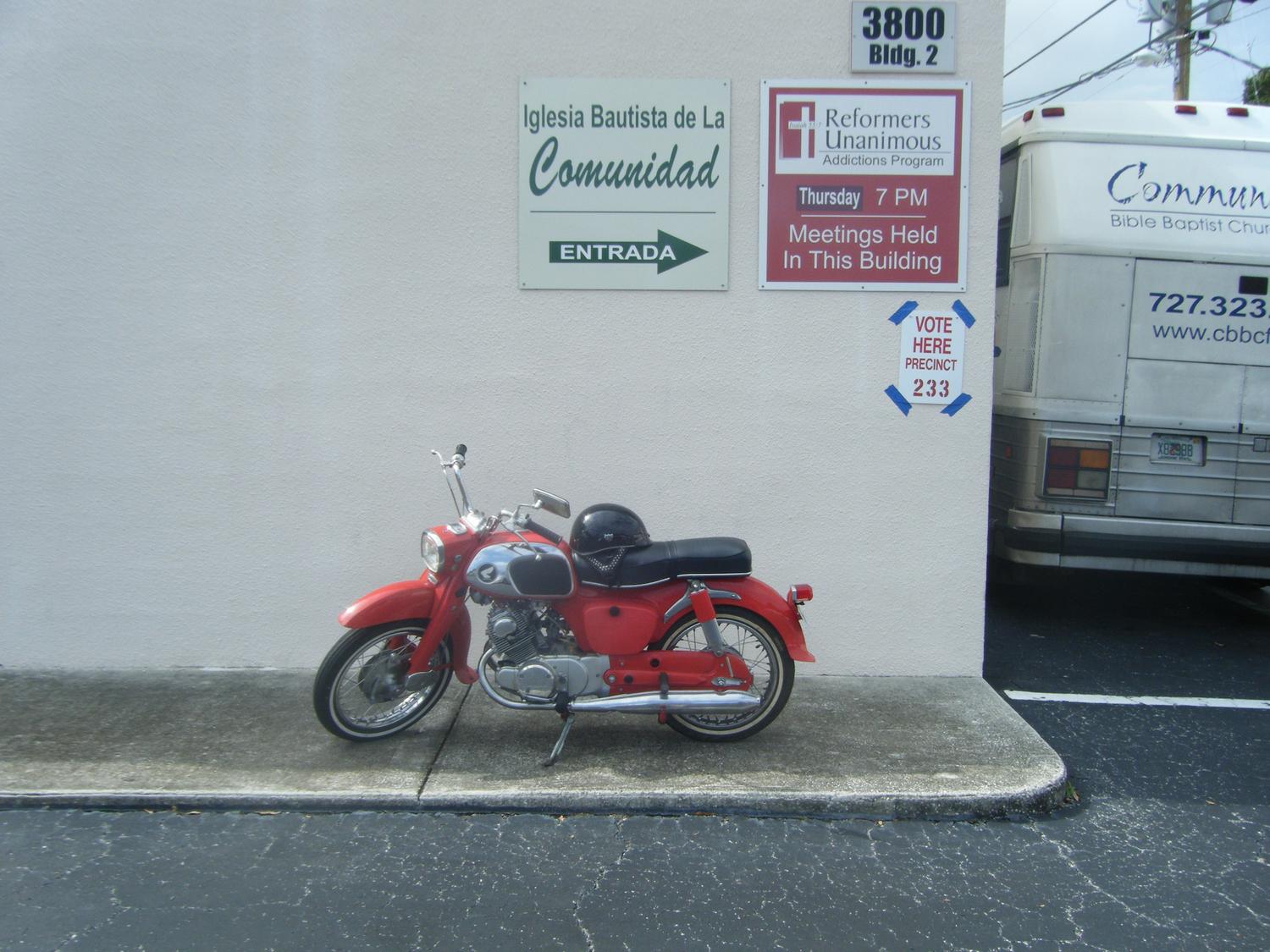

Greetings as well Marc and Welcome! Plus 1 on everything Spokes has said. This has been a great resource for a bunch of folks for these little bikes.
We also look forward to your pictures as we are a visual bunch around here...seems we can't enough of looking at "the same old bikes"..;)
