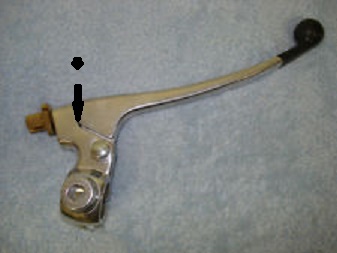

I allways keep the cluth released with a bolt or pencil at the lever end
Do you mean always while the bike is stored or when warming it up? Having it parked or stored the the clutch always released would weaken the springs unnecessarily.
