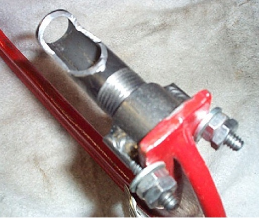

The VJMC website has a PDF on how to manufacture your own valve spring compressor if you don't have drill press. C Clamps are cheap at HF so I have dedicated one that worked well on both my single cyl and twins.

Cool. Given how inexpensive a C-clamp is, I could probably just weld the pipe section to the clamp itself.

Actually just weld the receiver for the "pipe" to the clamp. I find being able to position the opening on the pipe to your best position is useful. Total cost less than $10.00.
