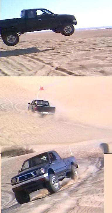

Hows it handle over the woops?
You just keep your speed up and skip right over the top of em. I did this a few times at very high speed before this work and it bucked my rear end up about 5ft higher than the front and my guy friend let out a scream like a little girl which was extremely funny. I still make fun of him.
I have seriously skipped over some dunes at speed and it goes over em very well. If I slow down things get worse so trying to stop in the middle of a bunch of big ones isn't a good idea. I have re-inforced the cab from the bottom or else the middle of the transmission hump floor area will crease and/or RIP right in half. I did this on a 1992 Toy ext cab before.
Here is a little in-cab footage of my truck going around some traffic at Pismo. It's funny to see the reactions of people that get passed by my truck in the woops.

And you want to see the travel we're pullin? I'm sorry to post such crappy res pictures but it's f'n hard to get someone to take pictures of you! When my V8 is operational there will surely be much better pictures of some action coming this way.
