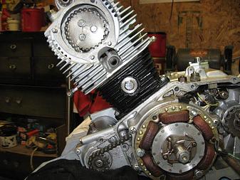

The photo shows the cam sprocket timing mark on the top. At the same point the "T" on the crank is lined up with the timing mark on the rotor and both pistons are at tdc or very close. I can adjust both intake valves to specs but when I rotate the crank 180 degrees, I cannot adjust the exhaust valves. Ain't this fun? Plus, do I adjust both intake valves then rotate the crank and adjust the exhaust valves? Or do I adjust one intake valve and the exhaust valve on the opposite piston then rotate 180 degrees and do the other intake and opposite exhaust? I'm gonna go take a couple excedrine and go lay down now. Ya'll have a great weekend.

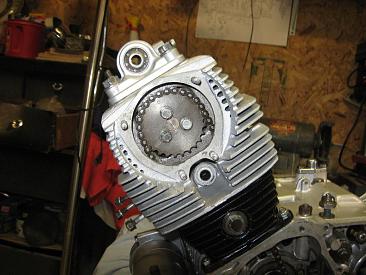

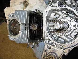

Ok, here,s a couple shots of what I was talking about last night.The first one shows cam sprocket mark on the top while the rotor mark is lined up with the "T". The second shot shows the alignment of the timing sprockets. I used a silver Sharpie to highlight the sprocket marks. Thanks to everyone for their help on this project.

I just got out my service manual (I found it after doing my rebuild) and I have a picture showing that the official way of setting the timing marks is 'up'. The cam sprocket mark goes toward the top of the head. The crankshaft sprocket mark also goes to the top of the head. The book's wording makes it sound like it is as you said, as far as possible. Though as we have said, 180 out makes little difference. Both sparks fire simultaneously.
That said, the manual doesn't say much about the valve assembly. I will say that rotating the crank 360 won't change anything. When the pistons are at top dead center, you should have 2 valves closed on one piston (the power piston) and an exhaust valve just slightly open on the other. (Yes, even at TDC one valve is slightly open on one side. This is why the valve timing is so damn tricky). If you know which is the power piston, I would adjust both valves on this side simultaneously, then go 180, and do the two on the other. You can check for the power piston by pushing air through the exhaust of both cylinders at 180 or 360 to see which one seeps. That is provided they actually seal : p
