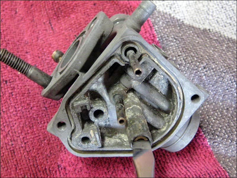

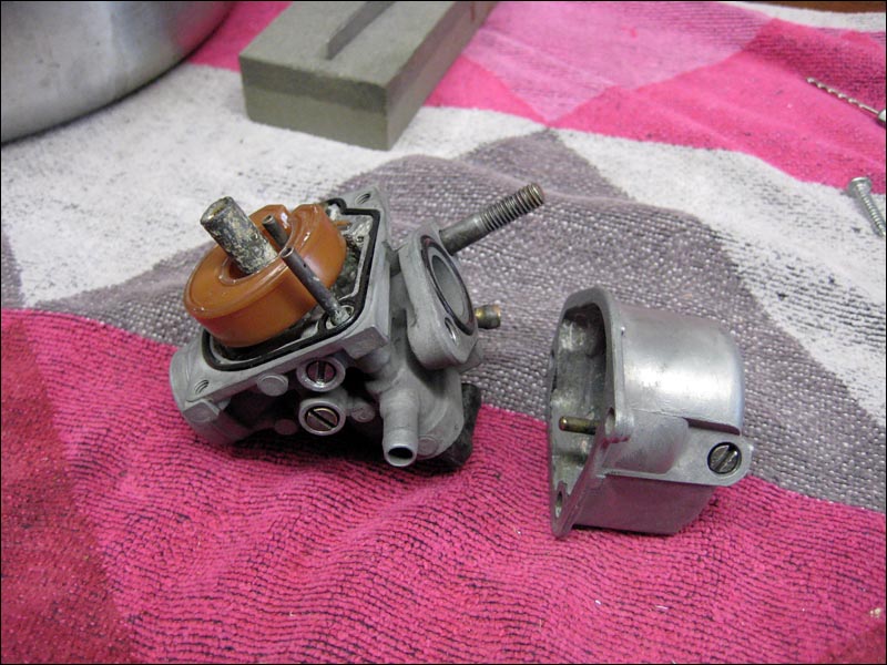

Here is your big enemy... dirty carb monster.

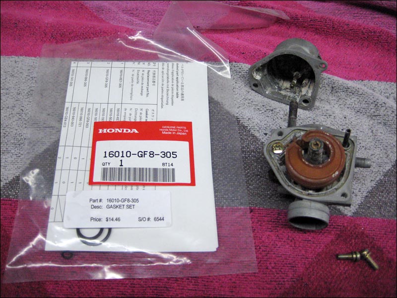

So once you have your gasket kit in hand just sit right down on your stool with some coffee and start scraping sediment out of the carb.
Unread 12-01-2008, 11:42 PM

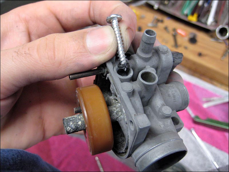

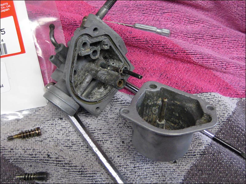

I didn't take a picture of the carb before I started cleaning as I can just say it was just dirty. The main bowl gasket was completely rock hard as well as the gaskets on the throttle screw and the mixture screw. The gasket for mounting the carb on the engine was chewed up from a previous installation so every gasket was failing in every way.

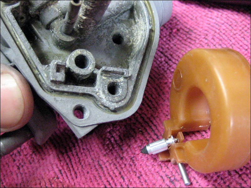

Here is a look down the mainjet and also the needle which is rubber coated at the point. It's still in great shape so I'm happy here as you can tell. There is still plenty of sediment to be removed and I spent a few minutes scraping in order to prep it for some chem dip to really clean things out. Yeap that's right, you are in luck. I'll show you the only way to clean carbs as far as I'm concearned.

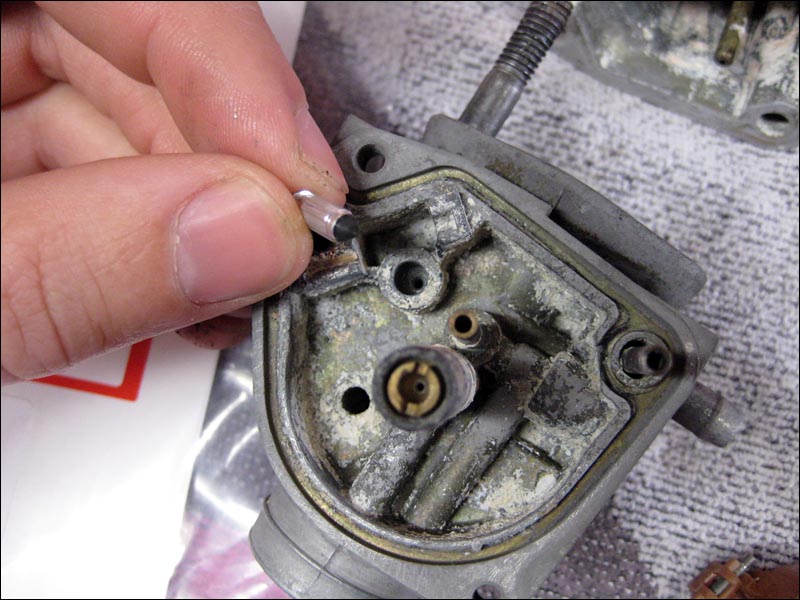

I used a few drill bits to turn down into the seat. I just use my fingers and spin the bit with light pressure in order to spin away any curst that might be down in the hole that the needle was pulled out of.

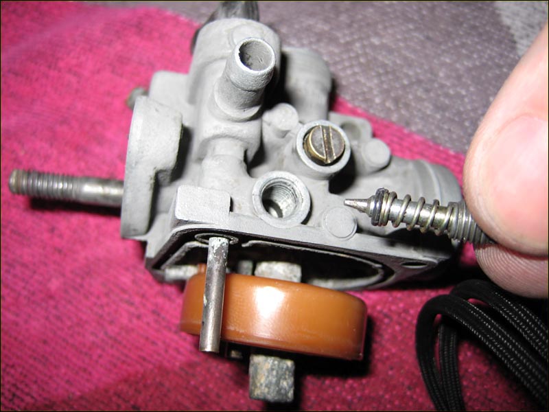

I just scrape about everything I can reach with my favorite scraping tools before I put it in the dip. Here you can see the idle adjust screw on the top and the mixture screw on the bottom. FYI they go in the carb in the same order from top to bottom.

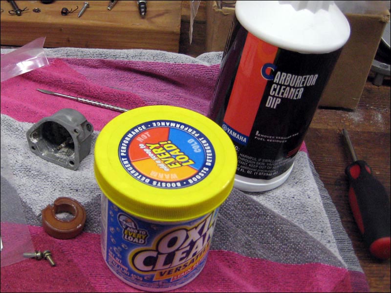

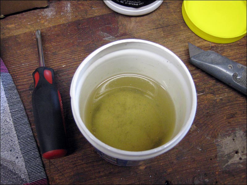

Now here is the stuff. It's Yamaha carb dip and nowadays it's not as toxic but it still works great. They used to call this stuff the green slime back in the day... so I hear. I was shocked to see it still no the shelf of my local motorsports dealer. It wasn't more than $12 too! Sweeet.
So what's up with the Oxy Clean? Well I HIGHLY recommend that you put this solution in a sealable container so you can re-use the solution. You mix it with water per-the instructions so make sure to read the bottle. YOU MUST mix with water. The solution can be used a few times before it becomes too contaminated so if you can seal up your container you can save it. This little one is just big enough for small carbs and other bits.
Unread 12-02-2008, 12:03 AM
This is just dip just after I removed the 50 carb from it. On the bottle of the dip it recommends that you agitate the solution as the carb sits inside it. Just shake it from time to time. Now the important part: the dip will eat away at the carb if you leave it in there for too long of a time. I left this particular carb in the dip for almost 40 minutes which I consider max time to do so. If you are dipping a rare carb or one that is much more expensive or hard to come by I highly recommend 15 minutes max and then removing it for inspection before leaving it in there for more time.

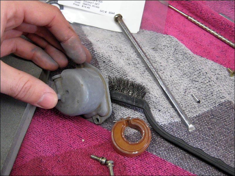

This picture shows some of the grey alloy coming off on my fingers! This means that the carb is ripe and it's being worked over by the chem dip a little too much. A quick wire brushing off after wards, some brake clean and a little air compressor and just about any carb will be working and looking like new.

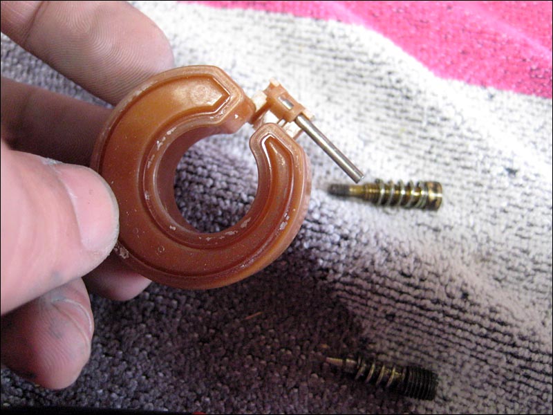

Clean the float really well and remove the steel alloy rod that it hinges on. Use a razor blade or something to scrape off any residue to that it hinges nice and free.

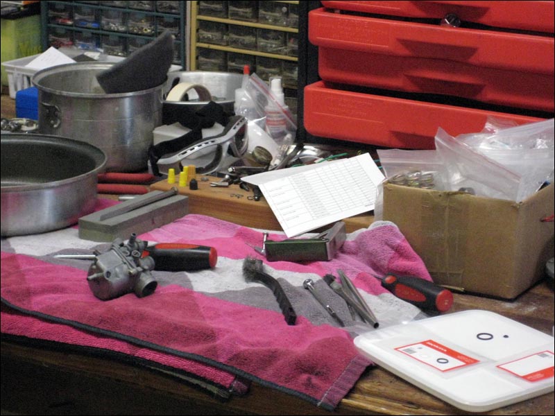

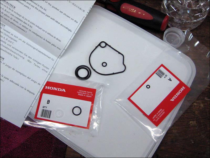

Time to get out the gasket set. I placed mine on a white plastic sheet so I could keep track of every tiny little seal and rubber o-ring.

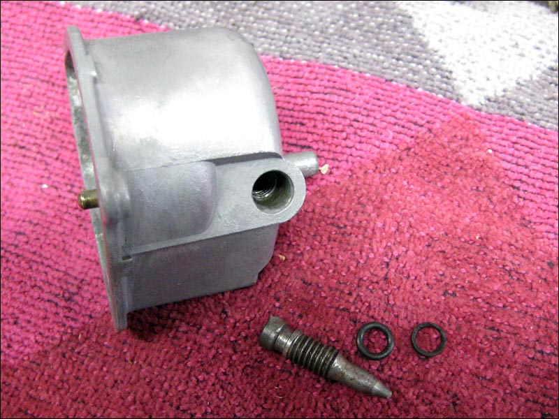

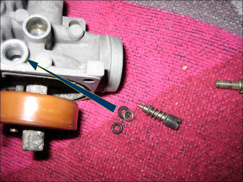

Getting down to the screw seal replacement: Make sure you remove the washer and the seal underneath it. These little guys are HARD to see and might look like part of you carb and not a seal at all. The new o-ring you see is exactly what you want to use to replace the flat, leaking one. Much better.
Here is the trick I used! Think smarter not harder.
Unread 12-02-2008, 12:37 AM
Here is the little ol o-ring and the washer installed on the jet ready to go back in. And then below I'm replacing the float bowl drain seal. This is the screw down on the bottom of the Honda carbs that NO ONE every uses but they should. It simply drains the fuel out for storage... but no one drains the fuel ever and guys like me have to fix them years later.
