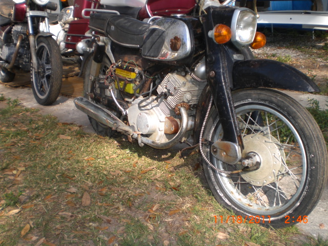

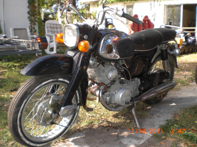

Thanks Larz. This is my 3rd CA160 build, so feel free to ask any question! Go to my album and check out my previous CA160 build. I have some parts blow up from a book as well as some scanned pages from the owners manual.
Below is my 3rd CA160, delivered today from Missouri. The shot is after a good wash and removing a real nasty chain and loose upper chain guard.
Much work is needed. The rims are bent, front fender bent, seat wasted, handlebars bent, footpegs bent.....real nasty...right down my alley! What is amazing is that the front tire, with the thin whitewall is nearly perfect and the tank hase some minor light surface rust with a clean petcock. I will begin to disassemble the bike soon.

It looks like this bike has sat idle since 1982. I base this fact by the last inspection sticker on the forks is dated 1981. From the road rash, bent footpegs and left muffler being beat up, it looks like it was dumped rather hard. I think the engine is OK for now. I base an early assessment of the engine condition on what the engine oil looks and smells like. If the oil smells like what you would expect dirty oil to smell like, that's good. If the drained oil has a real pungent, almost repulsive smell, then the oil may have gone acidic, which can cause rust in the crankshaft bearings. In my case I think I'm OK. I filled the cylinders with a good amount of PB Blaster and 2 cycle oil, then cycled the pistons with the kickstarter...slowly. Another trick I do with long standing old CA160 (and CA95) engines is after the draining of the old oil, I refill the crankcase to the top with inexpensive regular motor oil (any weight..any kind..price rules) and cycle the motor again with the kick starter. I drain off the whole load of oil and check for any bits or aluminum. Again in my case, I think I'm OK. Before removing the motor I loosened the side cover screws with my hand impact screwdriver.
The wiring harness is brittle. I had to cut the wires as there was no way to pull the connectors apart. I have a spare wiring harness that will work. This build will be a little easier. A few months ago I bought a rechargable impact wrench and it was a great help with long rusted bolts.
