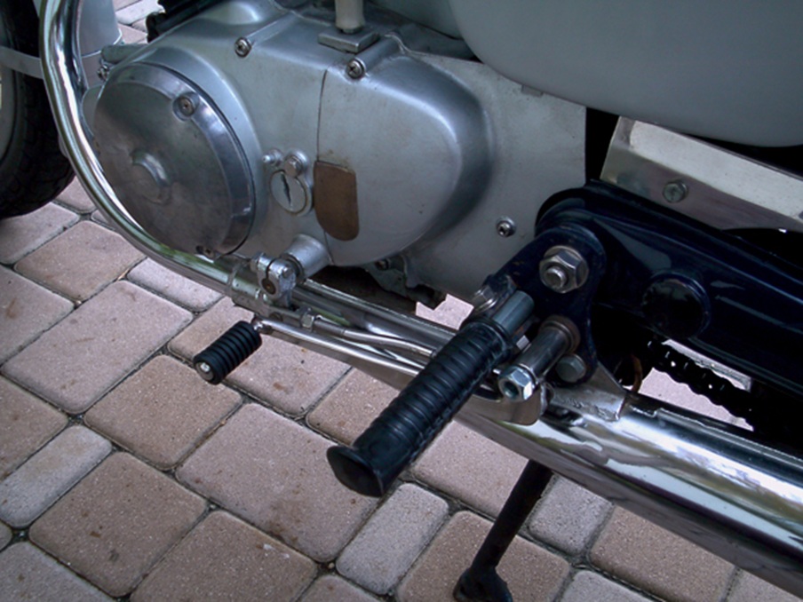

Hi, Sam- I'm pretty new to the CA95 game; but have built a few customs in my day... I picked up a CA95 reaaaally cheap and plan on making a custom cafe- sort of a CB92 "lite"- bike. I have a set of MCM high-pipes so the exhaust clearance for these rearsets wouldn't be an issue for me- Can you send me some close-up pics and/or some dimensions so I could fabricate a set? I have no issue making a longer swingarm spindle.

Default CB-92 Rearset LHS
Awesome shots- Thanks- I am still unclear as to the right hand footpeg arrangement; especially wrt the brake pedal- I have a close-up pic of the left side- anyone have one like that for the right side?
Thanks, Dave
