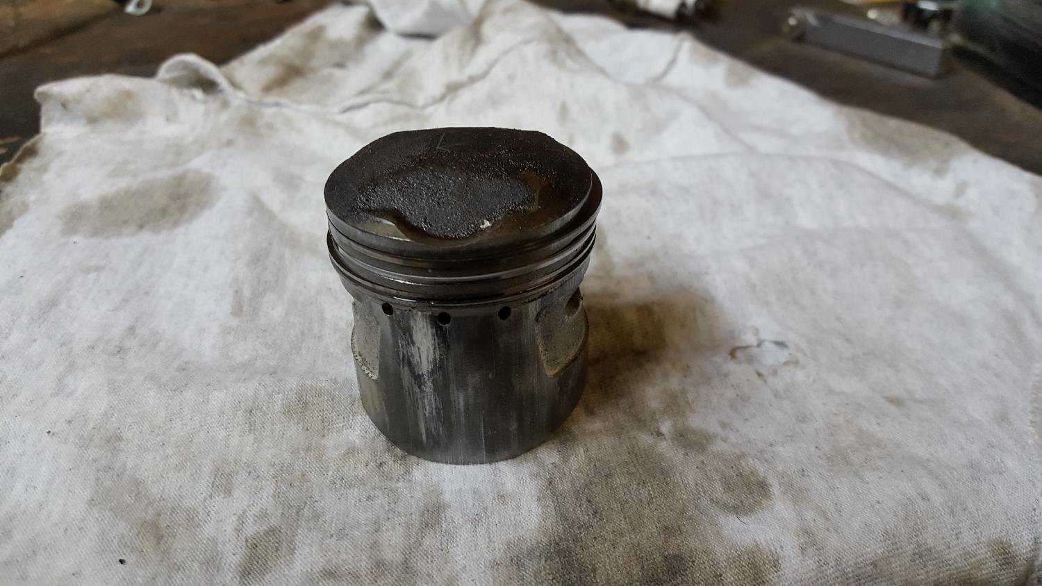

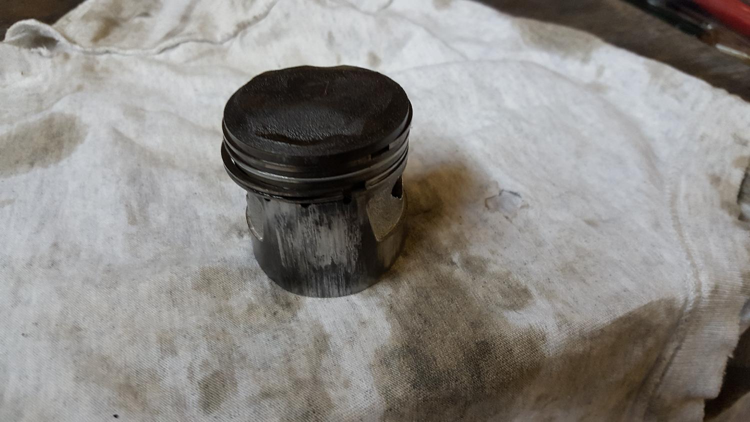

Got out of work early yesterday so I registered my 1963 and took it out for a spin and went about 5 miles to get it inspected. On the way back, about a 1/2 mile from home, the engine seemed to be losing power almost like it was running out of gas so I pulled over and it sat there idling away but it sounded like a super loose lifter on the shifter side or severe piston slap. No smoke though but there was some smoke coming out of the breather tube from the head.
I hobbled it home, checked the oil level which was fine. I let it cool then checked valve clearances which were fine. So I pulled the engine and tore the top end down last night. Plenty of oil everywhere on the parts. Everything looked fine except for the shifter side piston. It was scuffed pretty bad and the cylinder also. The rings were free also. Took the rings off and the piston was really sloppy in the cylinder. The other piston looked as good as new except for carbon on the dome along with the cylinder. I have never seen only one piston like this.
Just finished tearing the rest of the engine down to clean out any crap (aluminimum) from the piston scuffing getting in the engine and ordered new oversize OEM pistons and rings.

Wow that looks like 2 stroke lean seizure. I wonder if it wasn't getting oil on that side somehow. Plenty of oil on the crank on that side? got me stumped.

Yeah it does look like a 2 stroke seizure. There's probably around 300 miles on this rebuild/bore. There was plenty of oil everywhere and no stuck rings.
The only thing I can think of is the pistons themselves although the clutch side piston looks like new. When I sourced the parts off ebay, the ad stated that the pistons were OEM but when they arrived, they were in boxes labeled SK. SK's are aftermarket. The OEM rings were sourced from a different seller and came in OEM boxes. I noticed that the wrist pins were a little more snug than the ones in the original pistons so I am wondering if that may be another contributor although the wrist pins seemed fine.
Water under the bridge now. Cleaned out the lower cases, tranny, clutch and other misc parts. Will button up everything tomorrow and wait for the new top end parts.
I really needed to take the engine out of the bike anyway to repair the small nick in the paint on the top engine case in the back where the starter cable comes up into the airbox area. That little nick was really bothering me.

Hmm. Ring gaps were ok when you assembled? Wrist pin and both clips good on that side at disassembly? What are the ring gaps now I wonder? I'm wondering how it affected only one side and the other is ok. That steers me away from timing or fuel problems as they run on a joint plenum. Stuff happens but it's almost like forensic science to figure out why to avoid a repeat.
Possibly you got lucky on the other side running oem rings/wrist pins on aftermarket Pistons. Some Pistons run a different style ring than oem. Not sure about what's out there for the benly.

The picture of the bad piston looks like some of the pistons I found in really old engines.
I imagine that the rings may of been the wrong size. Perhaps they were oversize. The oversize rings installed on an aftermarket piston, stuffed into the cylinder caused extreme wear. Once the wear opened up the bore you lost compression in that side.
Another consideration is assembling the pistons and wrist pins without assembly lube. Assembly lube is key to providing a barrier between metal surfaces until the circulating oil reaches the moving part. That side of the cylinder began to bore itself out being dry the first thousand rpms setting the stage for extreme wear.
The SK pistons are not that bad. I have been "burnt" on aftermarket rings though.
Be careful with snug piston wrist pins. I again suggest using assembly lube when reinstalling wrist pins and new rings.
At this point I would bore the cylinders to match the oversize pistons.

I talked to the mechanic that I am going to bring my cylinders for re-bore and he thought along the lines I did that it was a two fold issue. After market pistons combined with a tighter than usual wrist pin fitting. This side was tighter than the other or the old pistons. He told me that he bets that the cylinder got a little ovaled on the inlet and exhaust side because the wrist pin wasn't allowing the piston to move as it should.
Kind of makes sense I guess.

Think I discovered the cause tonight as I was finally able to get back to reassembling the lower end of the motor. I didn't notice it until I was assembling the clutch. One of the tabs on a friction was missing. Don't know how I didn't notice it when cleaning the parts. It looks like it just fell? broke off? I am wondering if it or many pieces of it found their way into the gear case and somehow got into that particular cylinder first before anywhere else because the other cylinder looks fine and that piston only has a few very fine scratches in it upon inspection when cleaning.
I sure hope this was the cause. I am definitely ordering new friction discs.
