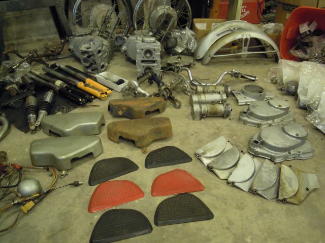

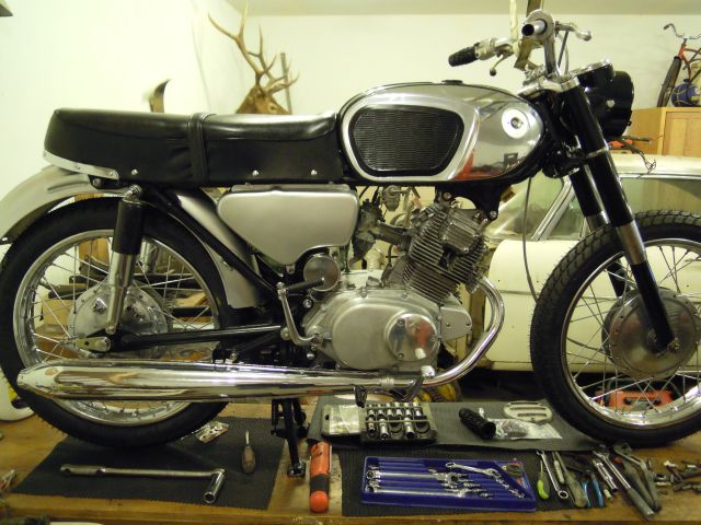

The first pic shows where I am at now with my CB160. As many of you know, I found a lonely motor on Craigslist a year ago. It sat on my toolbox for a couple days before I couldn't stand it any longer and began looking for parts to bolt to it. During this project I've met some great guys who love these old bikes just like us.
About a month ago I met a young man named Brandon through a craigslist ad. He told me he had a collection of CB160 parts dating back to his Dads racing days in the 60's and 70's. With just an agreement over the phone, he kindly took his ad down until we could work out a day to get together. Today, we met at his storage unit and it was a thrilling experience for me. Brandon had enough parts to build at least two fairly complete bikes, including two motors and all the other had to find parts, including the air cleaner covers. These parts have all been cleaned, bagged and labeled and I felt privilaged to become the new owner of his collection.

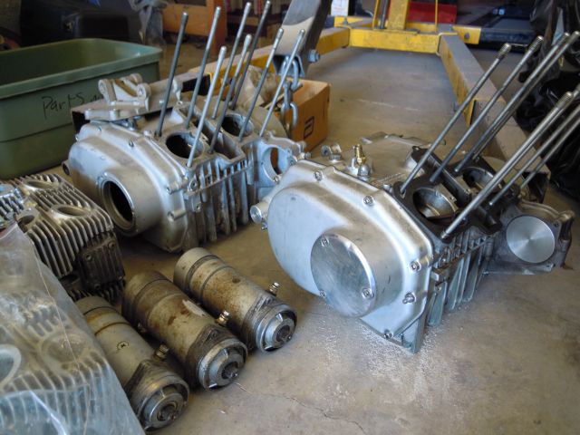

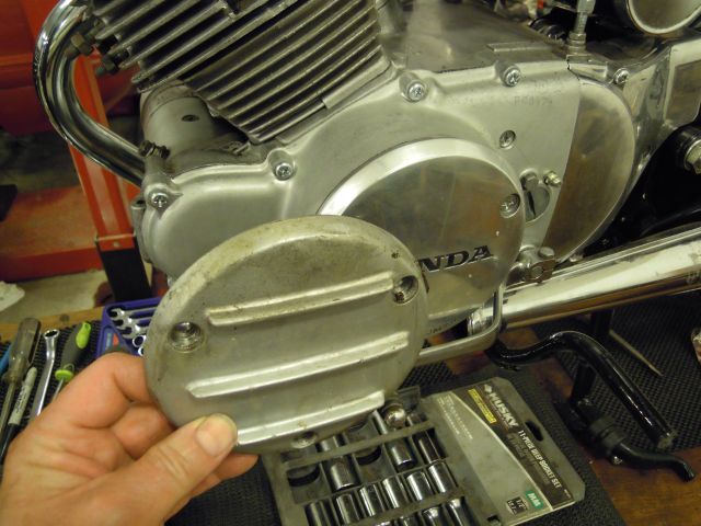

Now for a question or two. In the third pic you will see some knee grips, I don't know what they are for. Any Ideas? In the fourth pic is an unusual dynamo cover. I've only seen the type with the Honda logo, this one has fins. Has anyone seen one before? Probably not a factory piece.

I frankly use duct tape for my rim strips and am having no issues. I'd agree that some of these parts were used for racing. I see the starter block-off and case vent and these are two typical AHRMA mods. I'd suspect the cover is aftermarket, so probably fairly rare.I'm real jealous and you have a great parts stash now. I'm running out of 160 engines!

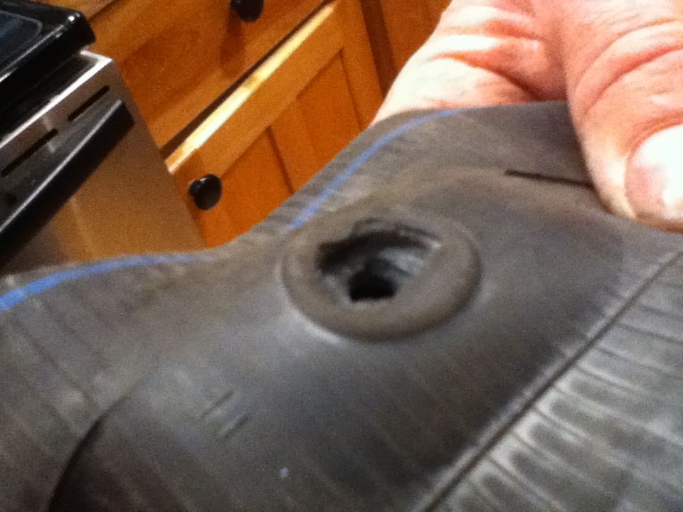

I finally got around to changing out the innertube on my rear tire today. The stem was completely separated from the tube at it's base. Of course, because the stem is restrained by a nut in an upright position I couldn't be forewarned of any tube creep as you can detect on an unrestrained stem on a bicycle tube. I wonder if it was tube creep and if it was, maybe I should leave that little stem nut off so if the tube does creep it will be given away by a tilting stem?
Unread 08-26-2013, 02:39 AM
I think the tire moved on the rim taking the tube with it. This is the first time I've heard of this. I would make sure any tire mounting lube is cleaned away before inflating the tire.

Based solely upon the original post I'd guess the stem was removed during the "Hula Dance" and the deflation was due to some other penetration or possibly rot in the tube (condition was not mentioned). Better tubes are usually reinforced in the stem area but as always ymmv.
My technique is to use a bit of talcum powder in the tire, inflate the tube prior to mounting to observe any possible defects, deflate tube, mount up everything, inflate to about 3/4 recommended pressure, bounce the assembly several times on the pavement going around the entire circumference of the rim, deflate and repeat then fill to pressure. If I'm really being careful I'll then submerge the rim (not the hub) looking for leaks.
I also use a stem nut on both the inside and outside of the rim.
This has worked well for me even on tubeless tires mounted to spoked rims.
Just my way and certainly not the only way. Typically I spend about $15.00 on tubes.

I looked the tube over for any holes, after not finding any, I put as much air in it as I could and stuck my thumb over the stem crater. I couldn't detect any other leaks and when it blew the other day it blew big time. I think I bought this tube at the Honda dealer, but I have no idea how long a 16 inch tube would sit on their shelf. They have some stuff on their shelves thats been there for 50 years, Including some NOS keyswitches, no CA95's though but I am pretty sure they have an S90 keyswitch, but I drift....
