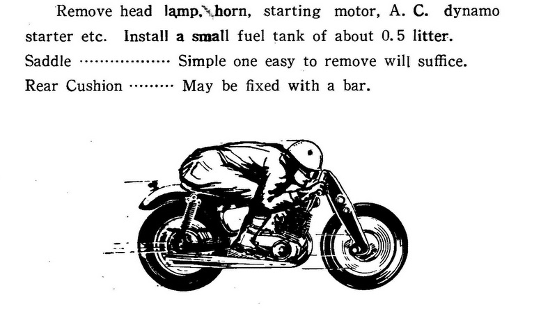

Suggested posture for 60mph speed attempt. Taken from an original Honda CB92 Owner's Manual
