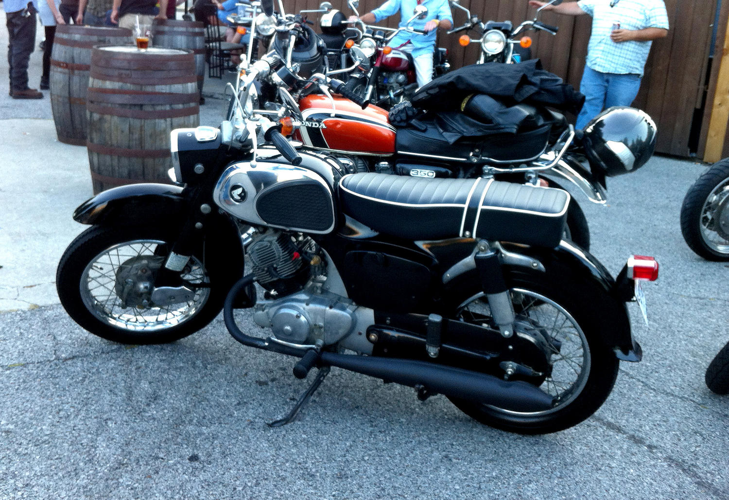

I have a 63 Benly 150 and the clutch is extremely hard to engage. I've tried all three adjustment points but it's either too loose or too tight. I installed a new clutch cable but it didn't help. I noticed there's a grease point on the side cover which I haven't tried to grease up yet. I'm hoping to have time to do that tonight.
Any other suggestions?
Thanks!
