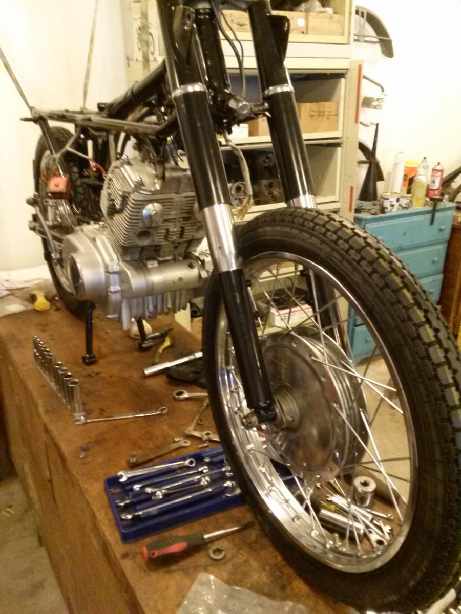

Hi Everyone:
You might remember I lucked into a pile of CB160 parts on craigslist, enough to build several bikes, and building bikes is what I've been doing. I finished my first CB160 last Spring and I figure I am a couple months away from finishing my second. Lately I've begun to feel like quite the craftsman when I consider the ease with which this second bike is coming together compared to the first. My Friends, Pride comes before a fall.
I made a point with my second bike to paint or polish every part before assembly. I painted the engine cases before assembly to avoid getting paint on the gaskets and so on. The past few weeks I have been working on the wheels. I started by finding a pair of nice rims, ordering a set of chrome spokes from overseas, and cleaning, sanding and polishing the hubs. I did a good enough job on truing these wheels that I decided when I have time I am going to go back and redo the rims on the first bike. I installed the rear wheel and tire on the bike a week ago and I've spent the past couple days getting the front assembly ready. Today was supposed to be the big day. The day bike number two would be standing on it's own two wheels. I got the wheel into position and picked up the speedo drive to place it on the hub and at that point I discovered I had put the front wheel together using a Scrambler hub. 160 Scrambler hubs have no provision for a speedo drive.....

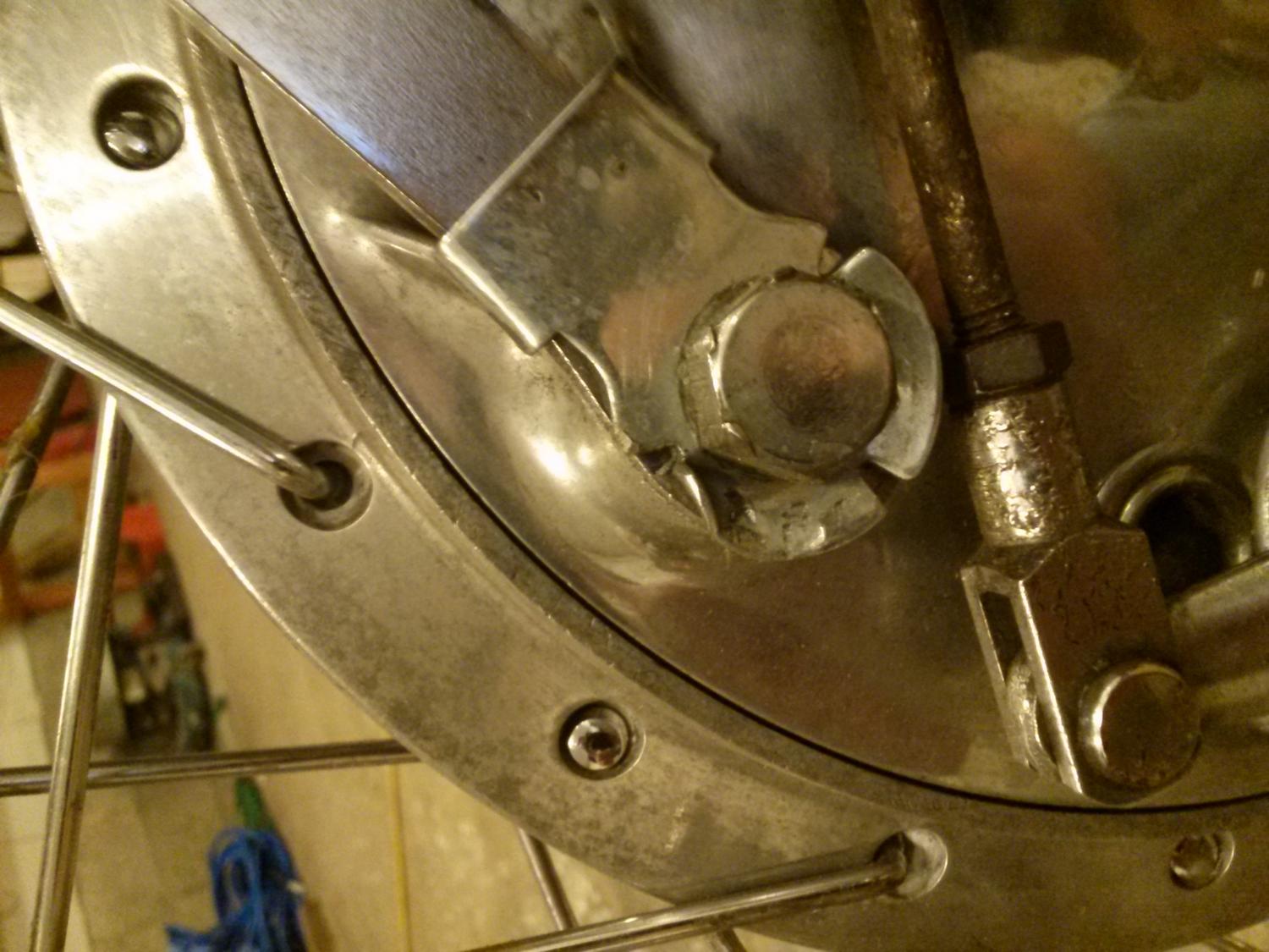

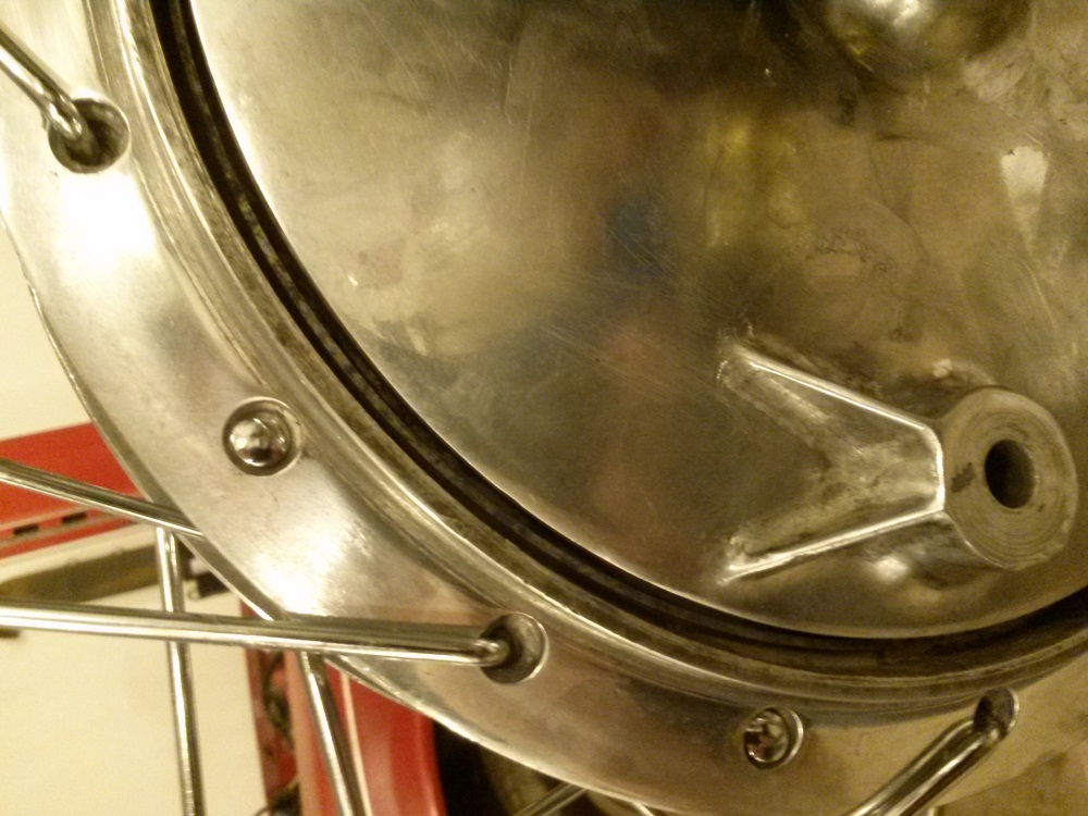

I have a cb160 brake plate installed and it is undersized. Here is a pic along side of the correct cb160 hub and plate.

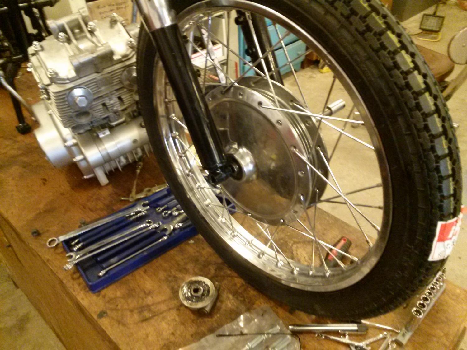

Hi Friends Thank you for your help with my front wheel assembly. As was suggested, de-lacing and re-lacing was good practice. I think the rim spins truer this time around.
I picked through my small pile of hubs and found a pretty good looking one, with proper speedo drive and brake plate clearance. I cleaned it up and polished it and started lacing it up. I had most of the inner spokes in their hub holes when I noticed I was starting to run out a little too soon. "What the heck? I've misplaced two spokes. I must of set them somewhere. Hmmm, they're not on the floor, I'm not sitting on them, ... what the heck?
I can't say how long I sat there scratching my head before it dawned on me that maybe I should count the number of spoke holes on that hub. But when I did, I learned Honda made a 40 spoke hub that is the same size as the 36 spoke hub.
On my third try I knew to check for proper brake plate clearance, correct speedo drive, and to be sure to count the freakin' spoke holes. I found a hub and of course it was the most oxidized rattiest, with seized bearing example I had. Because of the seized bearings, and because I enjoy looking at shiny new motorcycles I took it to Taylor Honda where the guys greeted me by name, cheerfully pressed out my seized bearings, bead blasted the inner drum, and sold me a set of new bearings for a total of 22 dollars, all while I waited.
Hopefully, in sharing my goofy mistakes with all of you, I can be of help to somebody embarking on a similiar project.CB160 back on track.jpg
