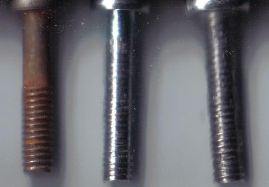

I imagine that a few threads get sacrificed in the process ... can you post a pic of what the re-cut screw threads look like?

Original, M5, #12
This image makes the M5 look like the threads are not substantial, because it's so new and shiny, but they are.
These are the very first experiments, run through the cutter, and with no other cleanup.
All three have the same "feel" going in, are not loose, and snug up with a natural feel.

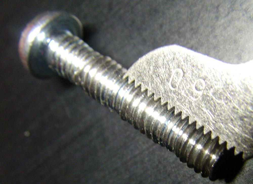

Thread gauge fits
Unread 02-12-2013, 02:32 PM
Look like a winner.
