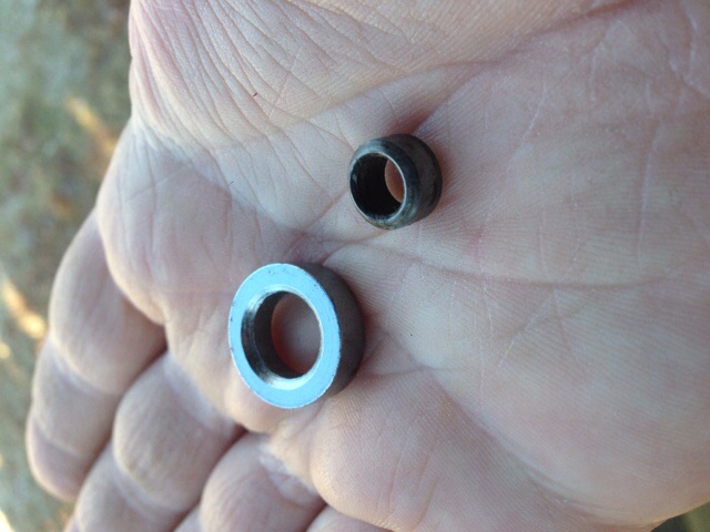

These are in my box of parts. Looks like a spacer and a collar. Any idea where these go? Thanks!
Spokes 12-10-2014 05:07 PM
The small bushing is your shift drum index bushing. Looking down at your engine, cylinder's forward, on the right side is a large hex flanged nut. When you remove that "nut" you will see that it has a tapered post on the end. That small bushing goes onto that post. You may get sloppy shifting without it. CAUTION: Use sticky wheel bearing grease to hold the bushing in the post when installing the bushing and shift index. Should the bushing fall into the shift drum groove you may have a hard time lining it up. If it falls free in the engine it will be a pain getting it out.
The larger chrome bushing goes to the rear shock absorber. Shock on the post 1st, followed by the bushing, followed by the shock nut.

Great! Exactly what I was looking for! Thanks again!

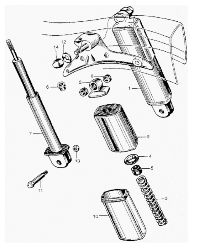

Spokes, I don't see the bushing in the diagram and my shocks fit right with just the flat washer. Is it for a different style shock or something? The two #8 bushings are the rubber ones I assume.
Spokes 12-12-2014 08:06 AM
My CA95 Builds have all been 1964's & 65's. The spacer on my later builds goes between the shock nut and the washer. I don't think it's a critical part like the shift drum bushing.
