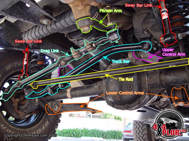

Broken Sway Bar Link Mount - 98 5.9 ZJ
4 Attachment(s)

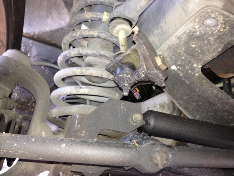

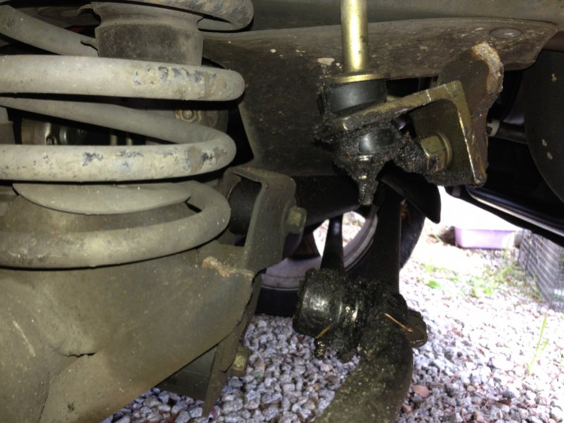

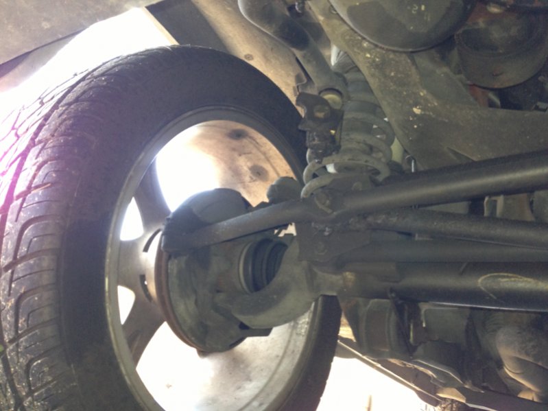

Must have snapped from the stress turning into this steep angle in my driveway every day.
3 Attachment(s)
Pretty sure having a stiffer addco swaybar just put too much torque on that flimsy little mount. That angle iron L-Bracket should probably be eliminated somehow, so it can just be attached with a straight-through bolt.

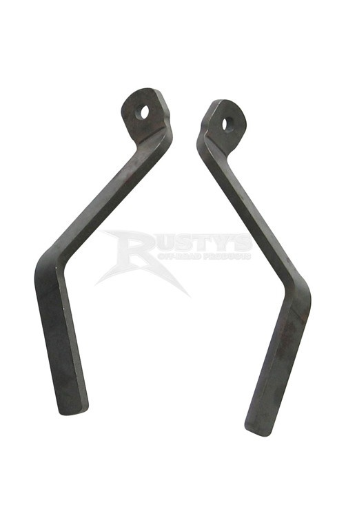

Some axle mounts like this would probably be the way to go: http://www.rustysoffroad.com/rustys-...unts-pair.html |
