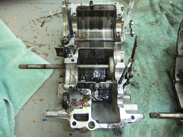

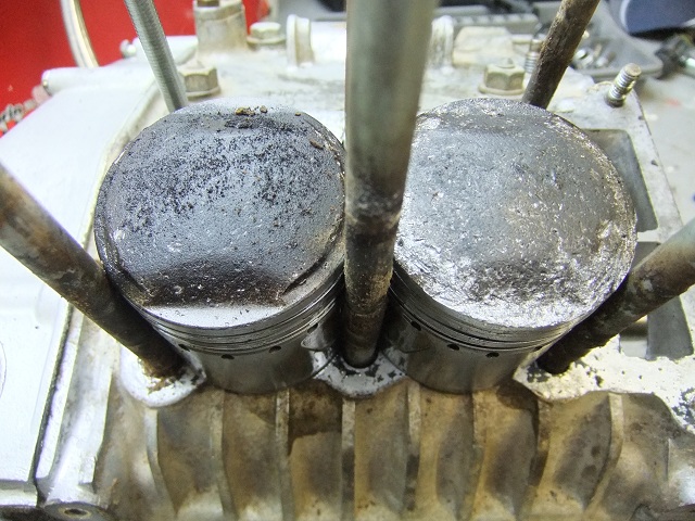

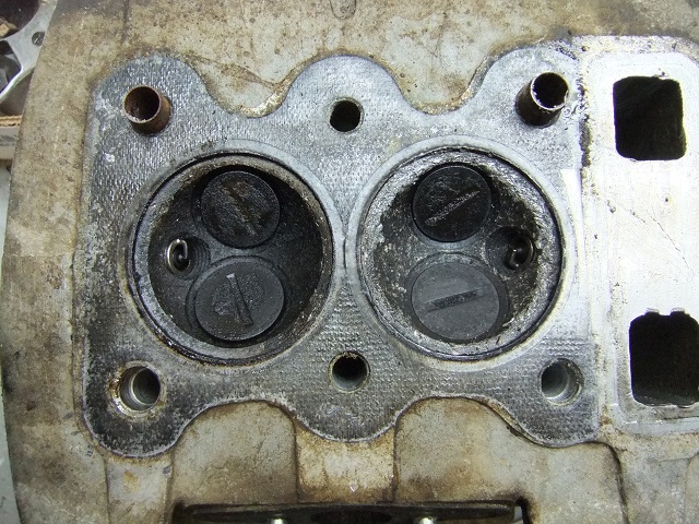

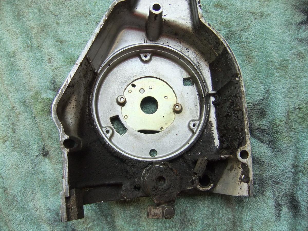

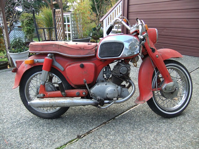

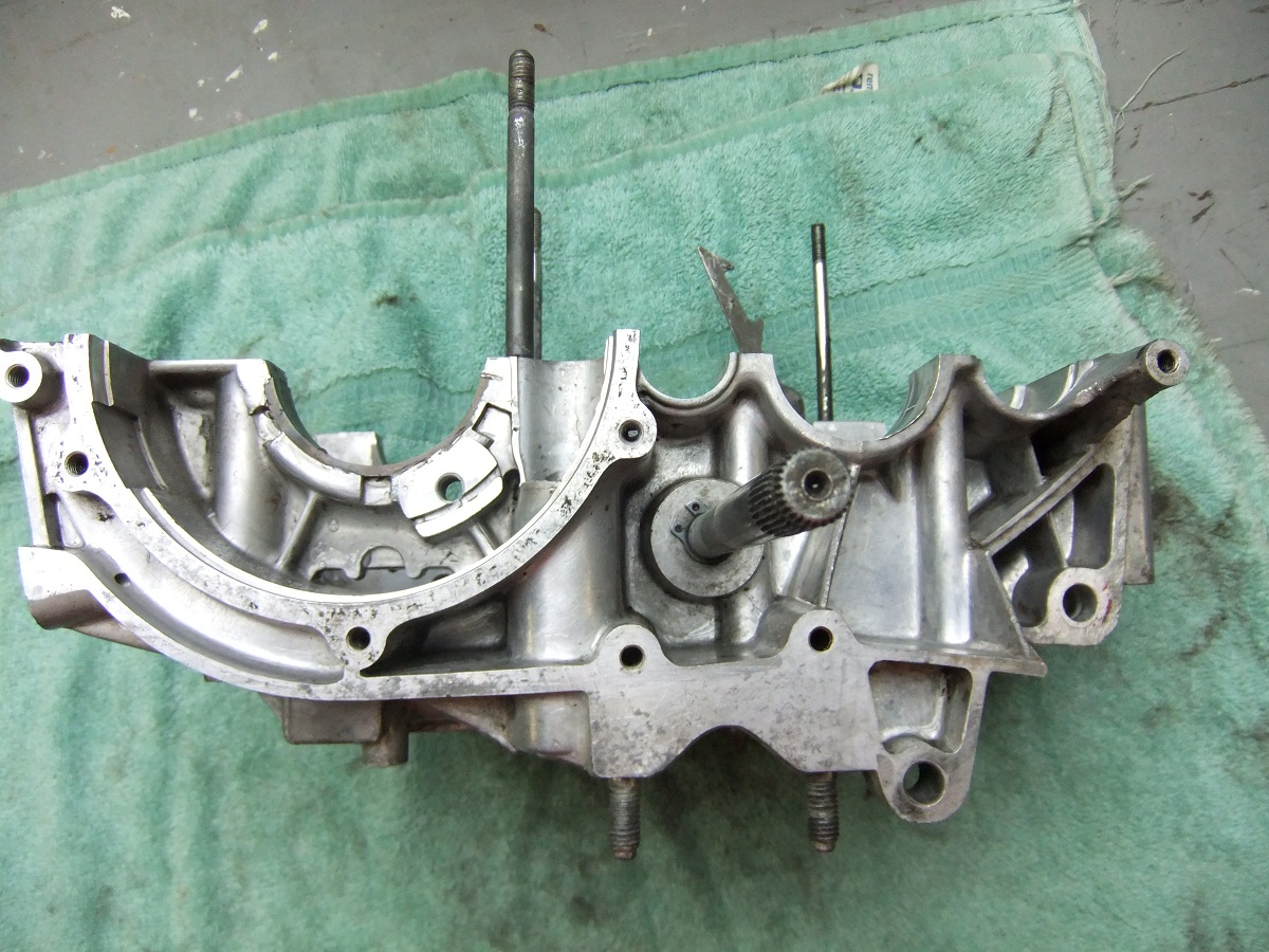

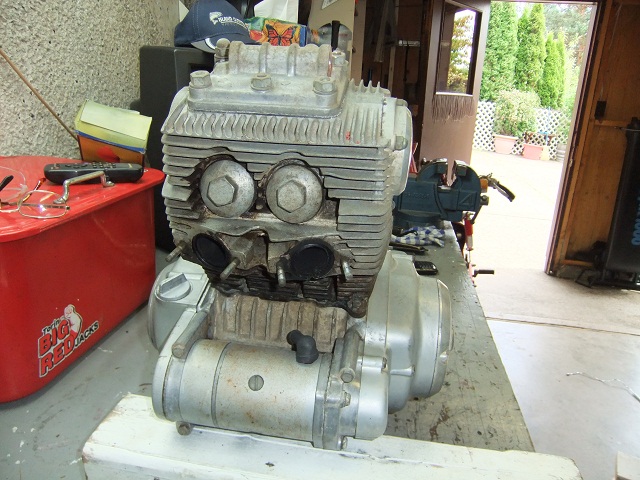

Hi! I signed in as a newbie some time ago but have finally decided to do something about the little bike I was given and document it here. It was built in November 1964 and brought to Canada by the previous owner, so the story goes. I got it from his daughter just before she left for Australia, come and get it she says the night before she left. I live in Victoria, B.C., she in Kelowna B.C. After a scramble to get a fellow to pick it up for me I dashed up there to pick it up. It's very rough and used as a trail bike. The last plate on it is a 1967 Alberta plate. It's sat for quite awhile as other projects came along but here we go. I've taken the motor out of the frame and started a disassembly to discover it's going to need a new head, pistons and rings. The bores look good and inside the cases looks okay too. The poor thing has been used, abused and put away wet many times. I did get it running which made we verry happy but the engine noises were quite something. The cam chain has been digging a gouge for itself for some time I think. Hopefully, in time, it will look some of the great projects done here.

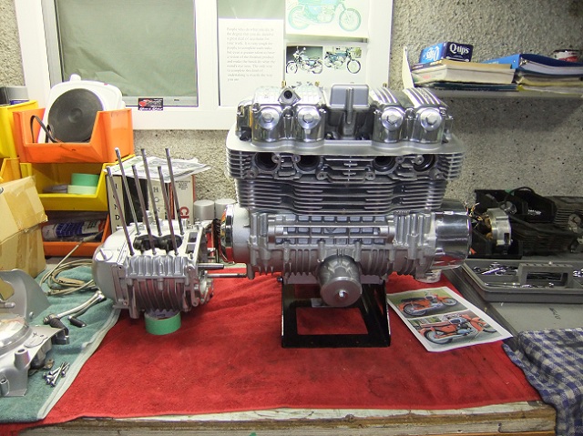

A few more just for fun. Cliff.

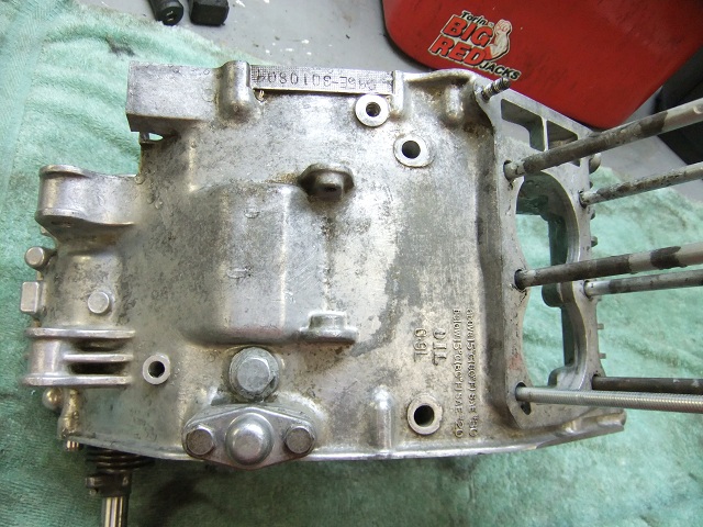

5 Attachment(s)

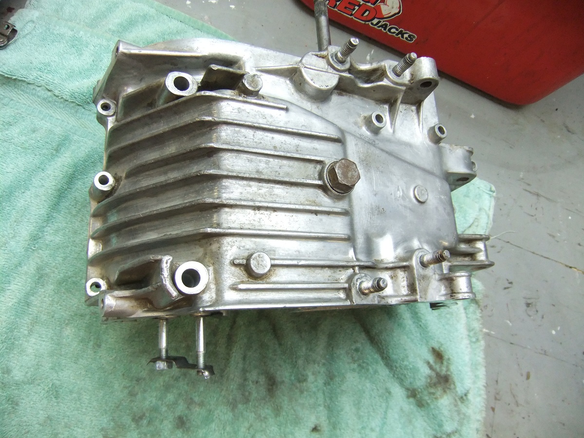

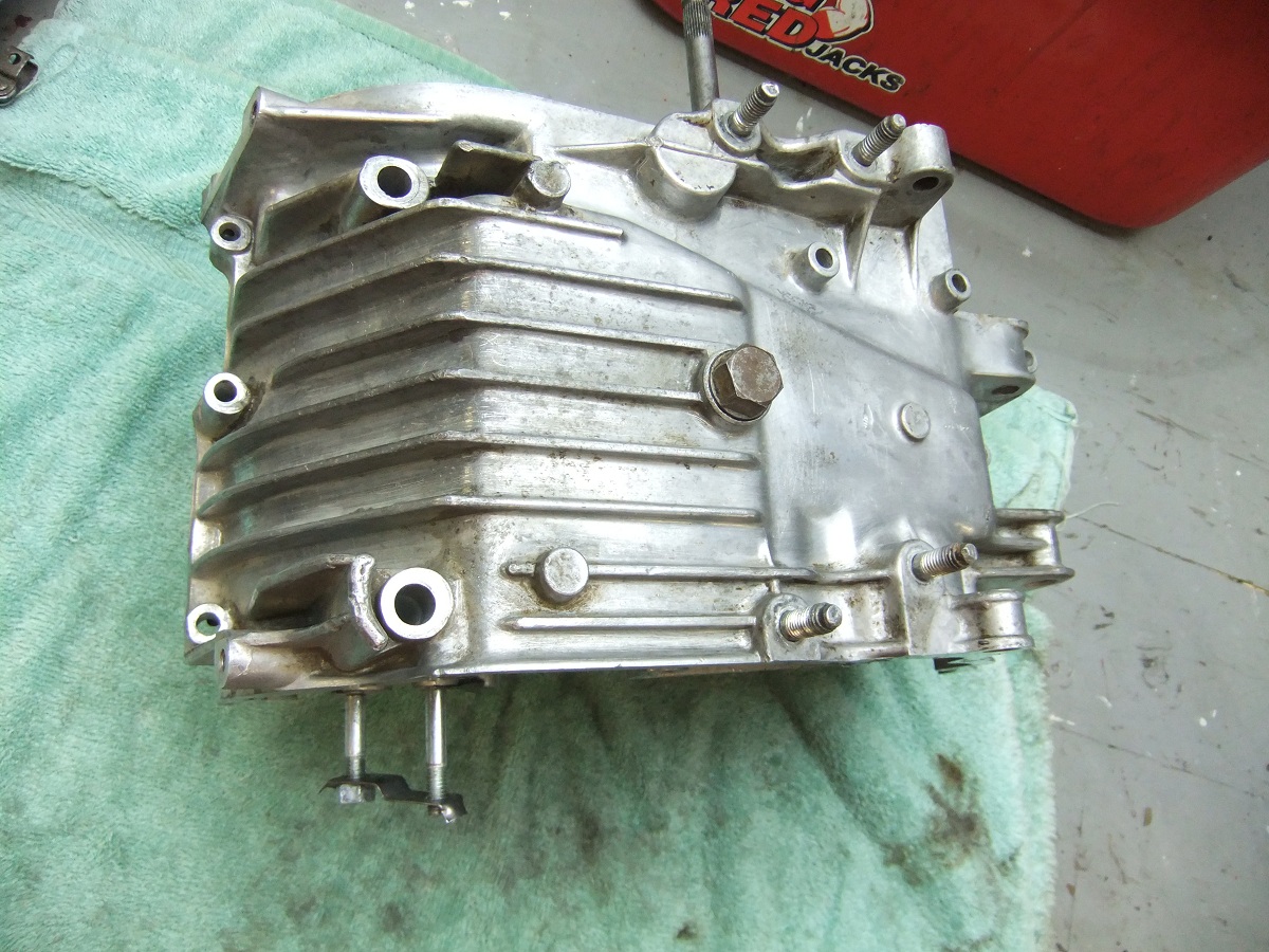

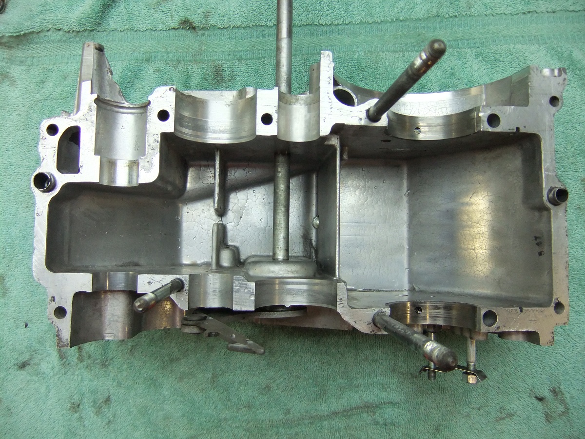

Got a bit of cleaning done today. Lots more to do. Cliff.

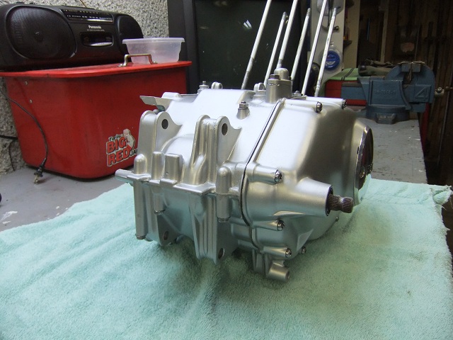

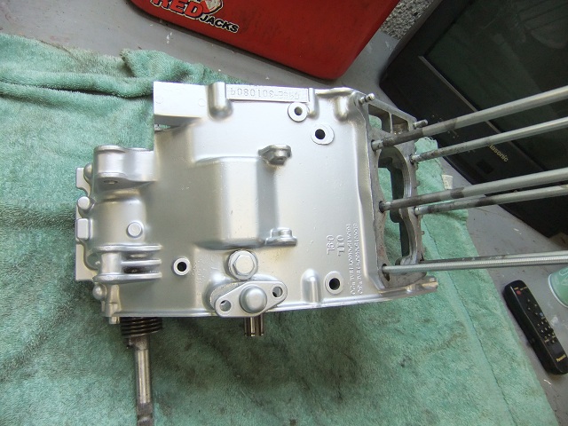

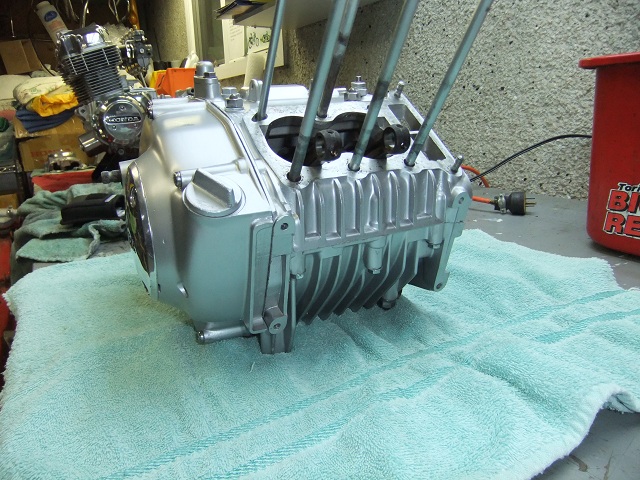

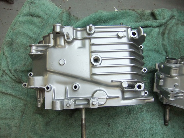

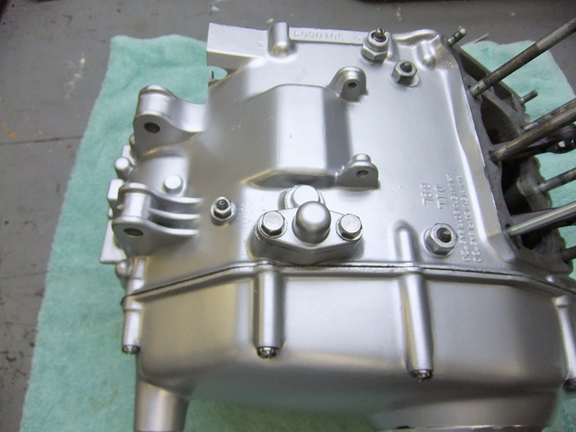

More puttering. Got the engine cases painted, Duplicolor Engine Enamel 1615, same as I used on my 750's. Nice colour and easy to use. Cliff
Magpie 07-29-2012 10:16 PM
5 Attachment(s)

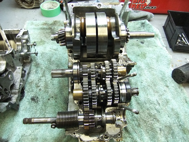

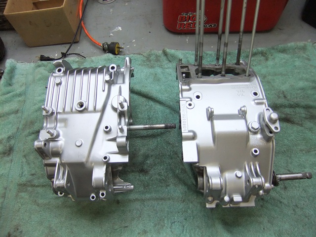

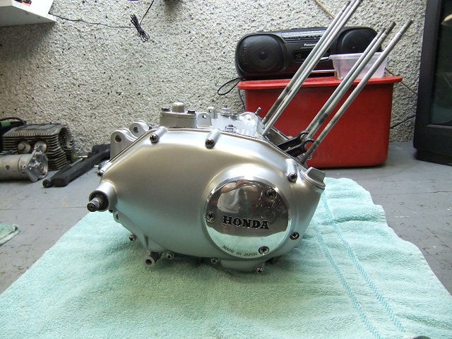

More done, motor put together and right side assembled. These are small motors. fasteners are probably too bright or shiny but I like that look. Left side of the motor will have to wait until I find a good head. Cliff.

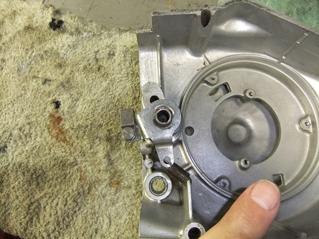

Cliff, can you post pics of the Canadian outer sprocket cover and also of the clutch mechanism in front of the sprocket.
Sam.:)
Magpie 07-30-2012 06:05 AM

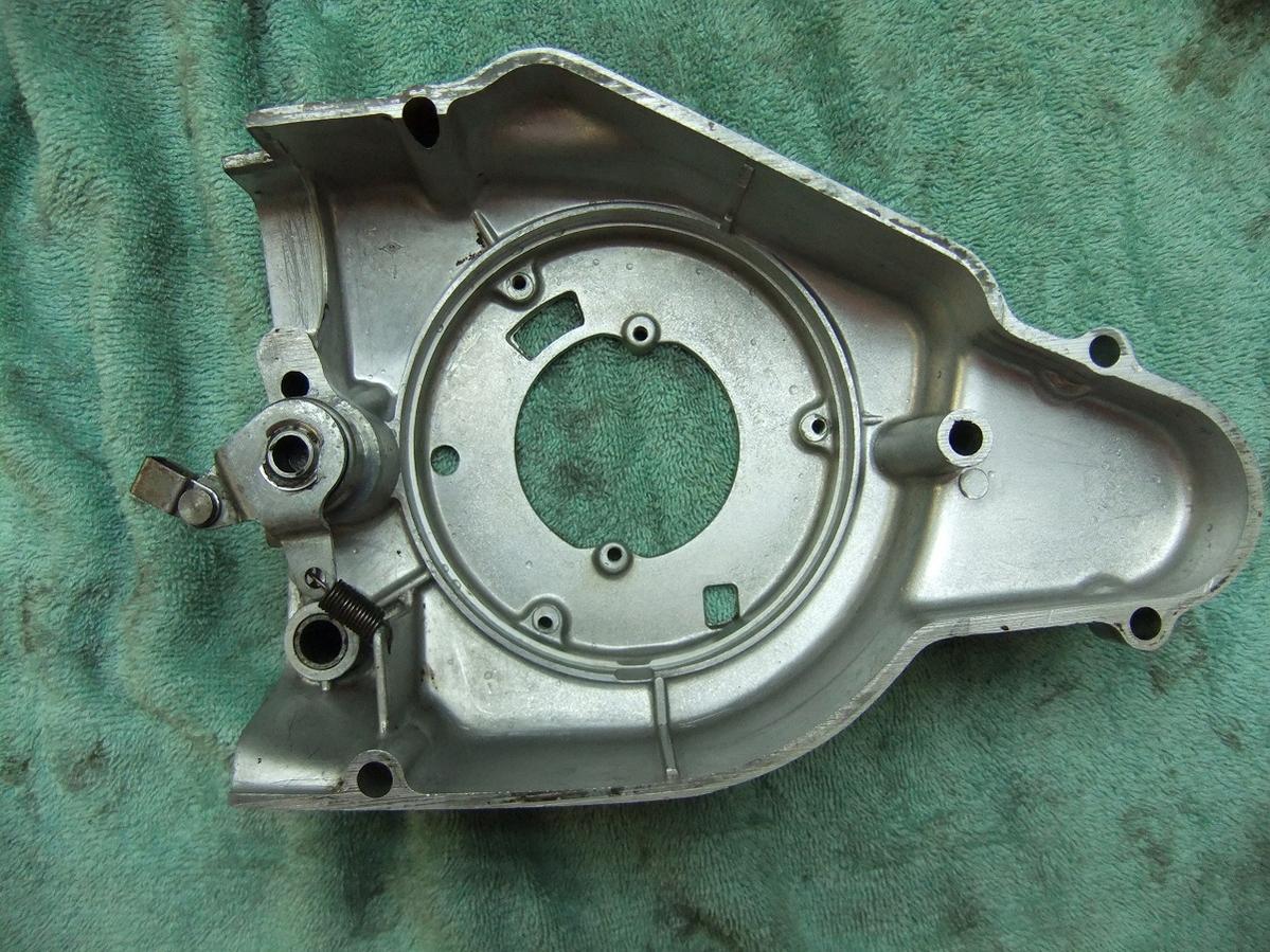

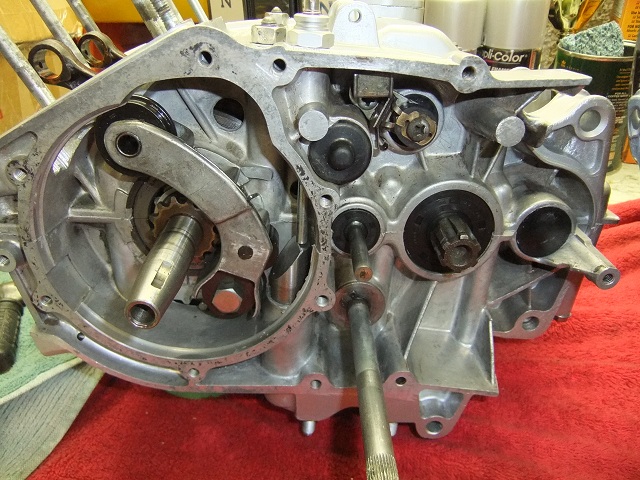

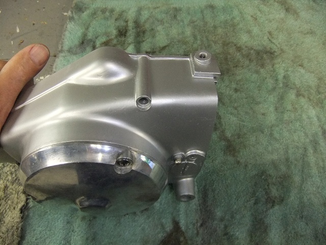

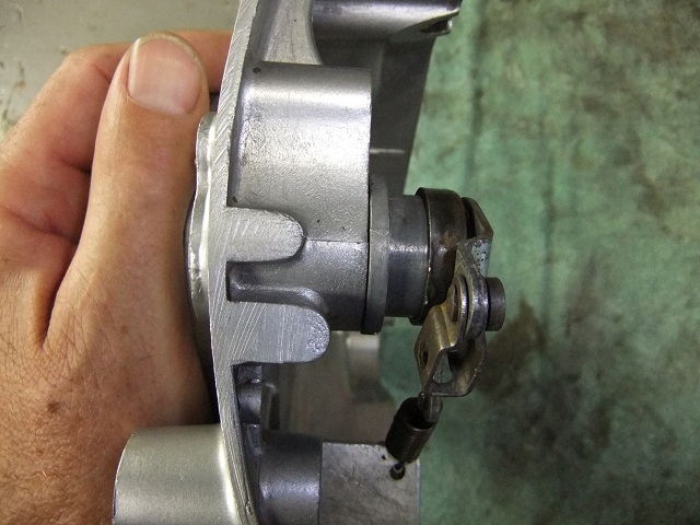

4 Attachment(s)
Hi Sam! I don't have a primary sprocket cover, in or outside. Here's a couple of pics of the cover in front of that. You'll see the guide for the clutch cable goes in the upper rear portion of it and would also be part of the outer sprocket cover. I have seen CA95 covers where the clutch cable guide appears to only go through the sprocket outer cover. Cliff.
