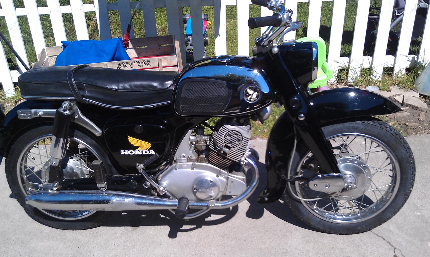

grandolepete 09-20-2011 11:09 AM
her she is. just got her this morning!
1 Attachment(s)
man im stoked.
Sam Green 09-23-2011 07:25 AM
It looks good enough to just jump on and ride:D:D:D:D:D not a lot of work needed we hope.

grandolepete 09-23-2011 10:18 PM
jst scrathes
yeah thanks, other than a few scratches she's in perfect order. i'm looking forward to low risers but, she too much fun to ride for now.
