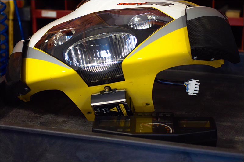

I've always read about people fitting HID ballasts and bulbs on their street bikes and I thought that the price was always ridiculous. I would MUCH rather buy a sweet new helmet or something for that kind of money. But recently my luck has changed.
I wouldn't normally do this but a friend of mine has had a pair of ballasts in his toolbox at work for a year now. His wife just had a baby so he was too tired to defend them recently. My bike can definitely use em! With all the trick parts going on the bike the HID will definitely compliment them. :lol: Now if I could just find the time to install the HID lights on the Aprilia Mille I would be set. And what do you know? Rain is scheduled to be overhead for the rest of the week. ;) Here is what I have. The King of the Obvious says, "They must be from some Toyota vehicle.".
http://fourwheelperformance.com/apri...lia_hid_02.jpg

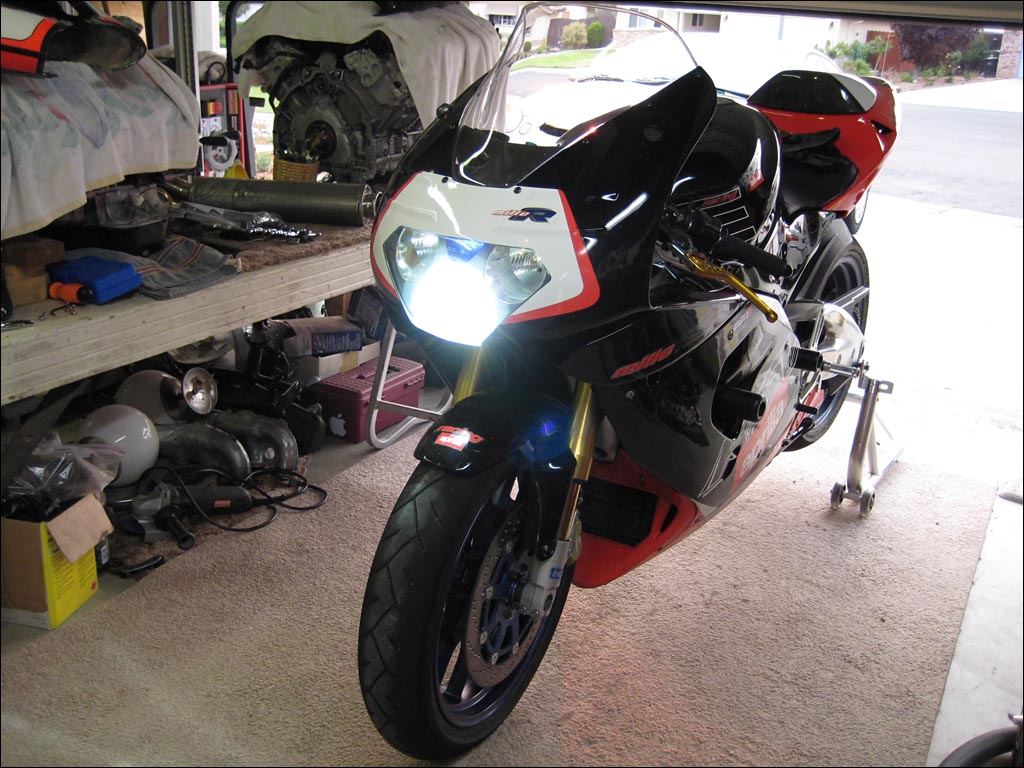

Yes I finally had a couple hours today to install my HID light. I just put the lowbeam one in for now because I want it bright all the time. Some time later I might find another one to match my spare so that I can have two going for the high beams.
http://www.fourwheelperformance.com/...idlight_00.jpg

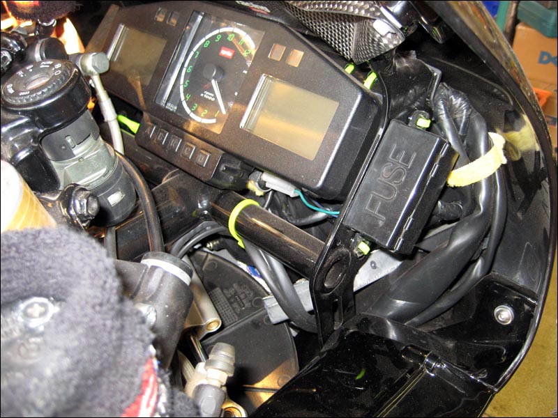

I got a bunch of pictures showing what I did to make this happen. It's wasn't so bad installing it. I was dreading having to place the ballast somewhere but I found THE BEST SPOT EVER... there actually was room inside the front faring and you'll be surprised when you see the location. More to come when I have time.
Smithers 07-10-2008 10:22 PM
** DO NOT install anything where this HID ballast is installed !! **
When your front suspension bottoms out or goes near the limit of travel it WILL go all the way up to the upper fairing! This is a horrible place to put a ballast. :(

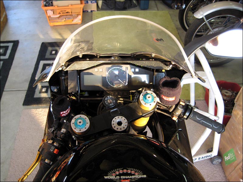

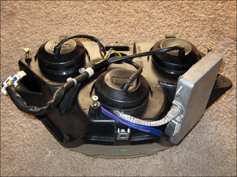

Here is the best thing I've seen as far as mounting the ballast. There is a shielded wire that goes from the HID bulb socket to the ballast. The high end components that you get from autos always have short wires that are shielded so I figure that it's not a good idea to cut them and make them longer. ALTHOUGH I've been told that it's not a problem as long as you use high quality wire. I'll pass on the extensions. It took me a while but I found a MUCH better place to mount the ballast than the route taken in these two pictures. This is the only way I've seen people mount ballasts on their Aprilia Mille but I knew there had to be a better way.
http://www.fourwheelperformance.com/...idlight_01.jpg
DO NOT INSTALL ANYTHING HERE WHERE THIS PERSON PUT HIS BALLAST !! If you hit something hard or use all the front suspension travel the front fender will slam up into anything that is here.
http://www.fourwheelperformance.com/...idlight_02.jpg

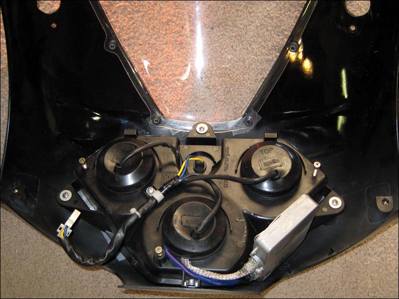

Here is what the headlight looks like with the ballast attached.
http://www.fourwheelperformance.com/...idlight_03.jpg
And here is the front faring while I was fitting things in there making sure it worked like it should.
http://www.fourwheelperformance.com/...idlight_04.jpg

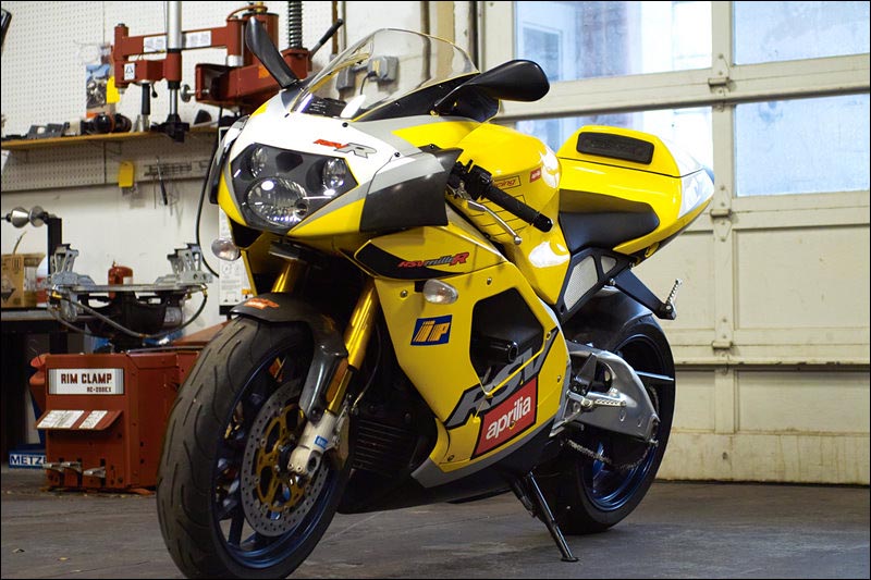

Well I rode around tonight to do a shakedown on my bike for tomorrows riding. I posted some info in another forum and thought I would repeat it here FYI.
I recommend playing it safe and finding a used HID ballast and bulb from a Lexus or Mercedes. Runs cool and it gets people attention even in the daytime. I have yet to see any oncoming driver flash me at night. If I want to see up in the trees overhead at night time I'll hold my bright light trigger on back roads. Some day I might try some of those Chinese ultra compact HID light ballasts for the two high beam lights.
These are a great mod for safety IMO. I'm not one to put blue lights on just to look cool either. I just want to see at night time. The Suzuki V-strom lights still have more light with it's huge reflectors. I can't believe how much light is projected out in front of my friends with just regular bulbs! I would love to see what kind of light would come out of the V-strom headlights with HID's installed. Of course they would have to be set up a little different because the high and low switch meakes both lights run low.. and then it changes both lights to high on "high beam". With the Aprilia it runs one light at "low" and then it turns on the upper lights for "high beam".
http://www.fourwheelperformance.com/...w_yellow01.jpg

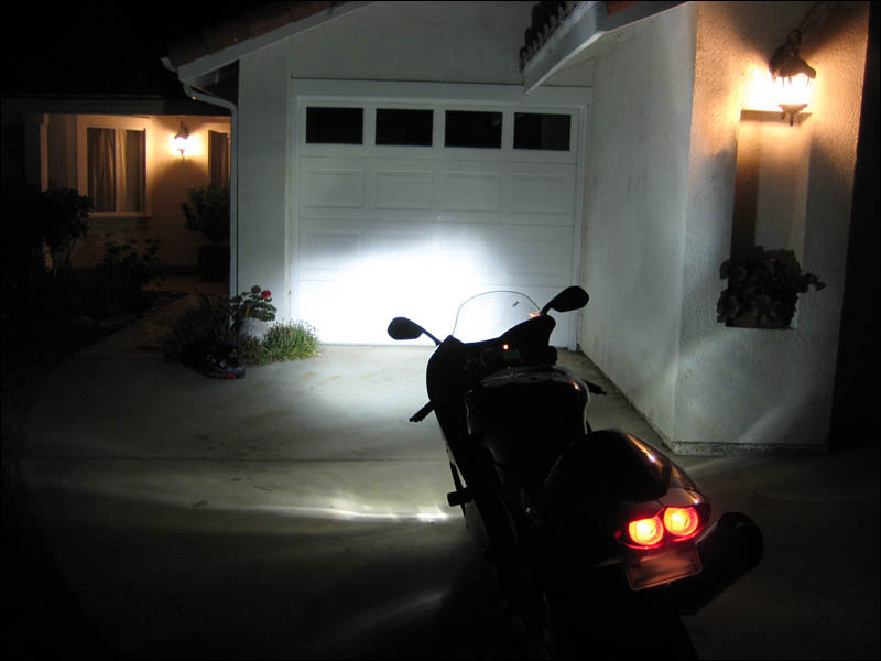

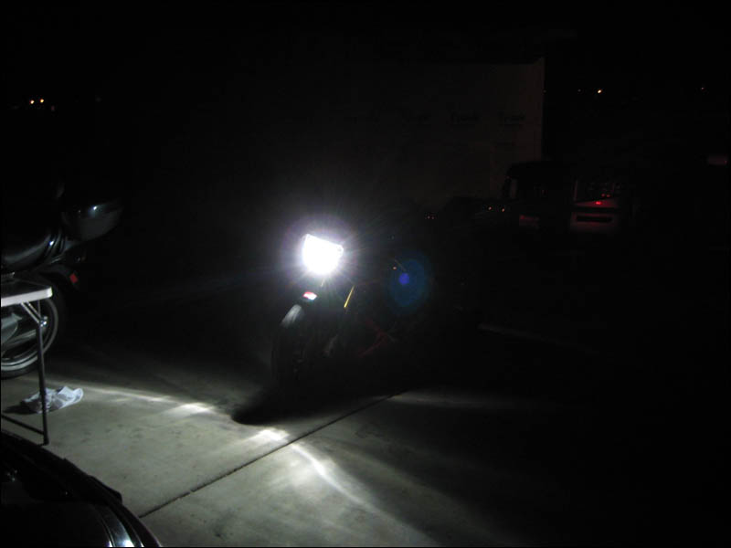

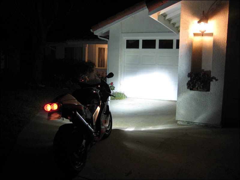

I never took some pictures of the actual beam pattern at night. So the other day after coming back from a ride I decided to get a couple shots so people could see. The housing actually puts down a proper beam pattern so that it doesn't shine directly in oncoming traffic driver's eyes. I was very happy with the result after my install. It's not like some of those cars you see going down the road with HID lights in them that were never intended to have them. :rolleyes:
http://www.fourwheelperformance.com/...id_beam_03.jpg
http://www.fourwheelperformance.com/...id_beam_01.jpg
http://www.fourwheelperformance.com/...id_beam_02.jpg
