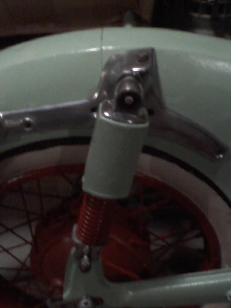

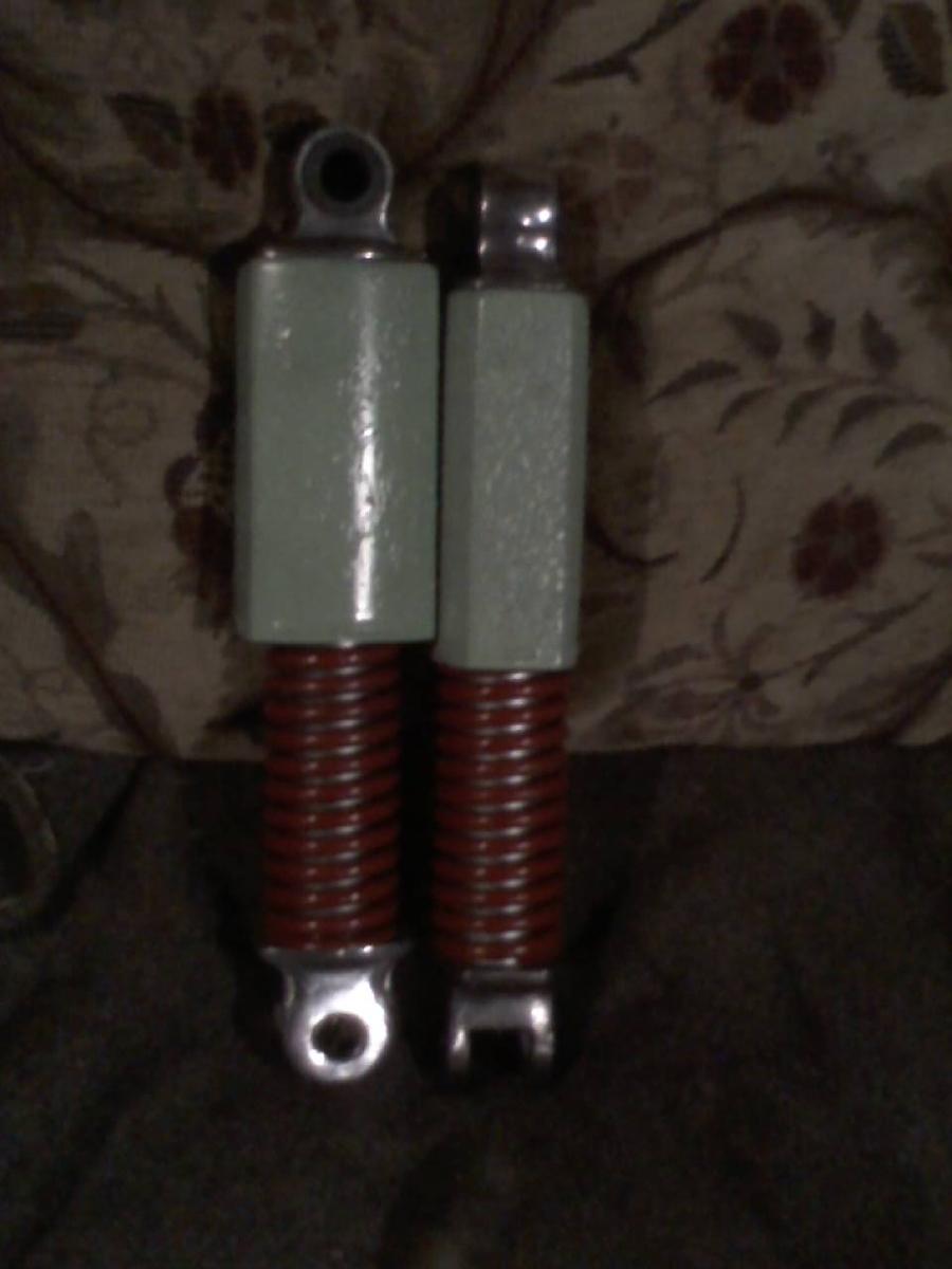

Jetblackchemist 05-10-2011 01:51 AM
Shocks rebuilt
2 Attachment(s)
Ok as promised I'd be back with pictures when I had my shocks finished...Basically, my shocks didnt have a slot after the top mount was taken off, so I used my dremel with a cutting disk and made one on each(worked like a charm) Next I did some painting and flipped the metal part to use as the upper part and ditched the broken cracked plastic, the metal was in horrible shape with big pits but no rust through...Some aluminum polishing later and re assembled tada...
